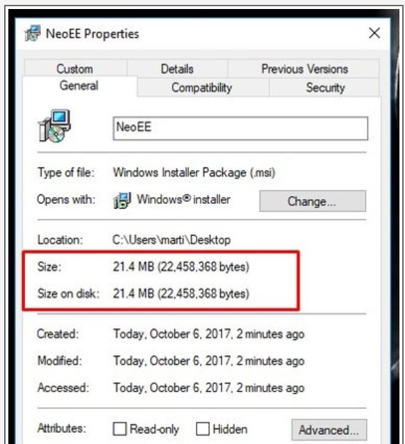

2. Make sure the file size of the NeoEE.msi file the same as mine:

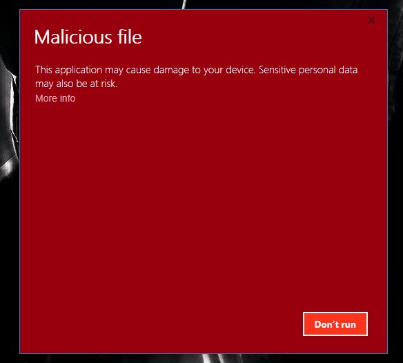

3. Run NeoEE.msi
You might get this error:

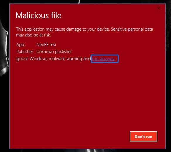

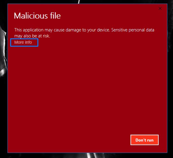

Click "More Info" and "run anyway" as shown in these picture:
4. Click as shown in these pictures:

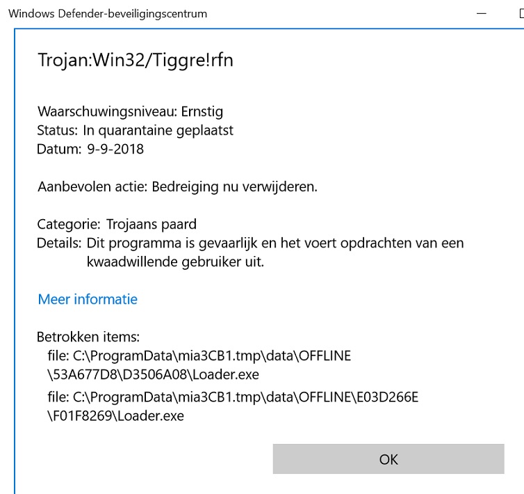

Recently I tried playing NeoEE with some friends. However I could not get retrieve the Masterserver data.
In the end I decided to reinstall the game and the patch. As mentioned in your stickpost above I recieved mutiple error messages. However, windows identified it as the Trojan win32/Tiggre!rfn. This is a cryptovalue miner.

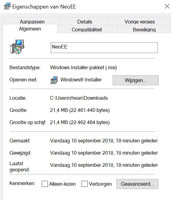

I then compared the downloaded patch file with the file you specified in your stickypost and found a slight discrapency.
File as posted above.

File downloaded on my system.
Could the file be corrupted somehow?
Re: How to install NeoEE patch
If it's downloaded from neoee.net then your anti-virus is giving a false-positive. Because it's unknown to the anti-virus it'll just assume its a trojan, but it's not.

Rhean wrote:Hi,
Actually there are some files which are useless to the game itself. They are named "Loader.exe" and they are the ones Win Defender tries to eliminate. If you let it do its thing, the game will run anyway, so i deleted them just to be sure
This is correct, the "loader.exe" allows you to use the multiplayer lobby with higher resolution than 1024x768. However it's not needed to play the game. My windows defender kept deleting it (even after I told it to make it an exception) so I play without the loader.exe.
