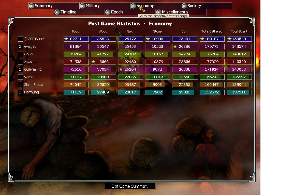

so this player yazen was glitching iron from what i calculated and most likely gold. someone should double check this though as this was a hard one for me to prove.
First we see he gathered 22560 iron. Next we see he made it to ww2 which cost roughly 18430 iron. If you look at this save we see he has 14 siege and 15flak, the total flak would cost him 1200 iron, while the siege would of cost him 2080 iron (this is with seige cost reduction in civ). add this too the iron he spent going through the epochs we have a grand rough total of 21710. He also had a isatair wonder but was destroyed and i did not even factor in the roughly 1k iron it cost to build this or any other lost units. so 22560 iron gathered- 21710 iron spent (once again is a rough estimate and a generous one at that) = 950 iron he should have left including the 100 you start with in sh however as you can see he has 3217 iron left. so just on my more than generous calculations he glitched at least 2k iron by ww2. I really want someone else to double check this, as it was difficult for me to catch, and once again I am being generous as he clearly built isatar wonder that i did not factor in

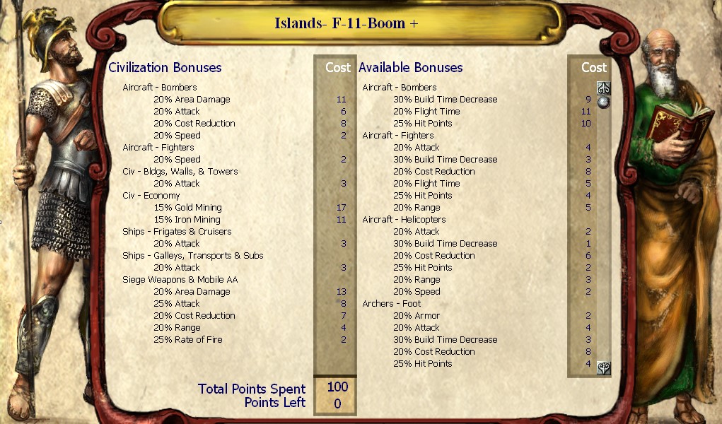

Re: yazen glitching
This is the civ he used. He also had 5 more artillery in production and 12 more flaks in production + lvl 10 upgrades for flaks was also bought for. So in fact he cheated more than just 4000 iron.
