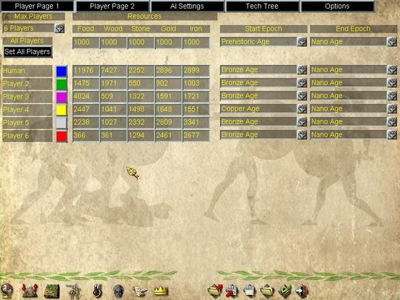

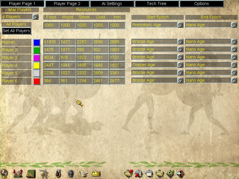

However he also had about 11976 food on stock, which makes it a glitch of about 11k food.

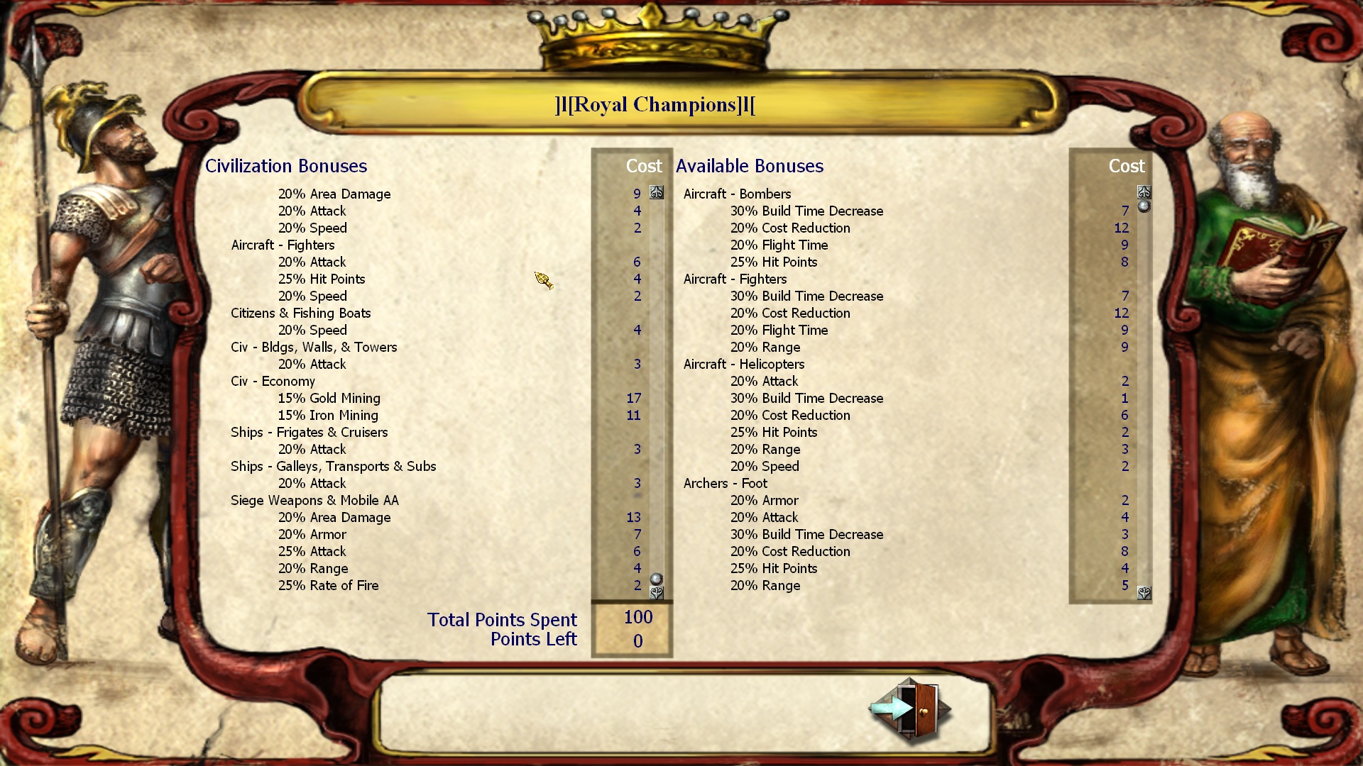

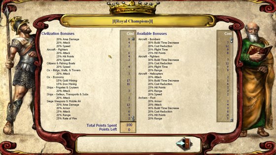

This civ shows he did not have ccr so the 297 he had cost 14850, and than if you add the cost for all resources it take to get to bronze + fishing boats that i didnt count and and buildings he build, this is well over the spent resources

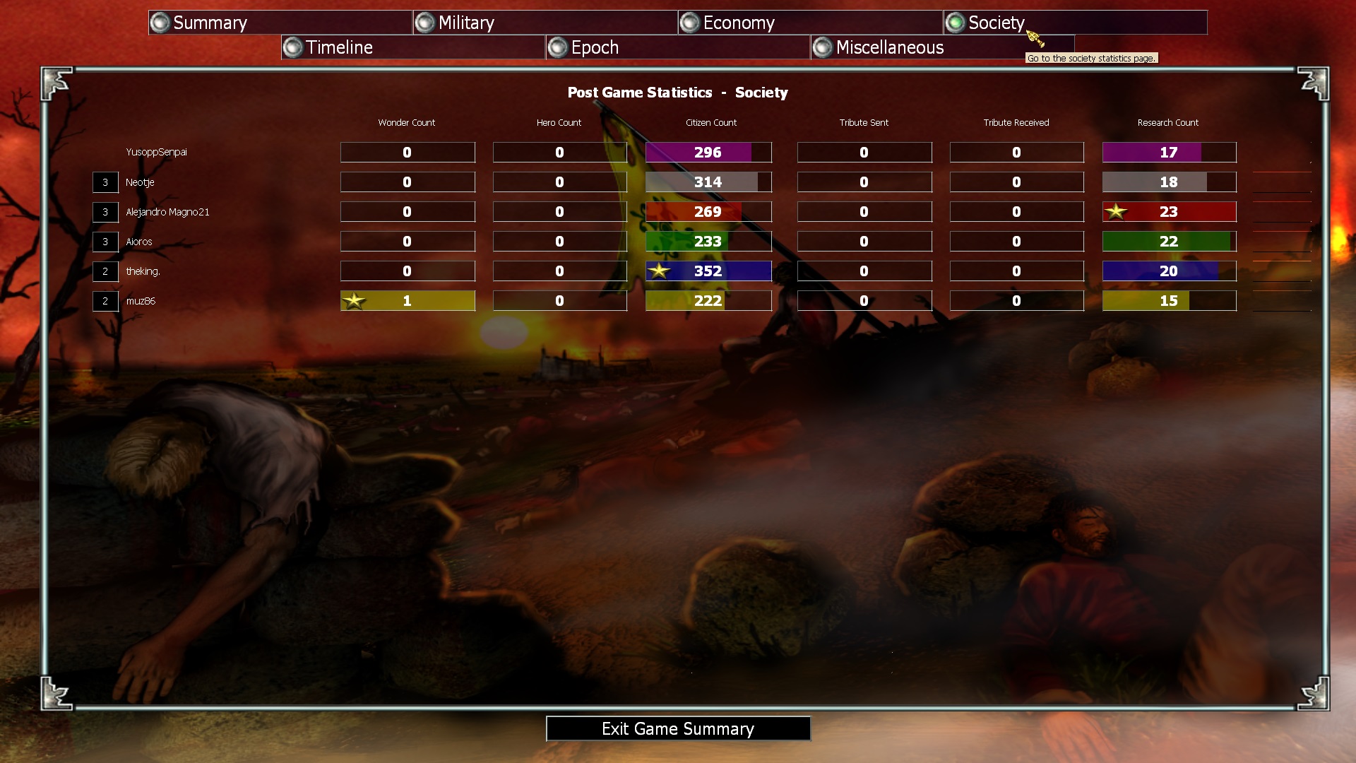

oh 352 total cits so even fishing boats it cost 17600, so with the cost of epoching he should of spent more
