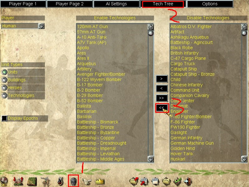

If you want more units, more tech, and more buildings than what's in a regular game you have to create a custom scenario. From Main menu click "Game Tools", then click "Scenario Editor". Once you have the editor opened you can unlock whatever tech/building/unit you want. For example if you want to unlock all units follow these three steps in the photo:
Note that this will only unlock the units to Player one (which will be you if you chose to make a single player game against computers). To change what to unlock see left side of the same page.
Any more questions just ask.
