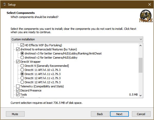

NeoEE (EE:AOC) Has to 2 installer options.
Default and Custom.
When you chose the custom option, there appears to a few areas of additional options to chose from.
Whilst some of those are simply additional in game content.
One that is most interesting and the one I am having issues with is the DirectX option.
By default Direct 9 (DX9) Wrapper is installed as the game is a DX9 game.
Yet there are 4 more options:
1 x DX9
2 x DX11 (10 and 11)
2 x DX12 (11 and 12)
I have tried installing with the 2 DX12 options and both times when loading the game, the mouse will simply not move whatsoever.
Both times I reverted back to the default installation (DX9) and the mouse moves in game without an issue.

Yes, because when someone use an NVIDIA card the Setup is configured to use DX9 by default.By default Direct 9 (DX9) Wrapper is installed as the game is a DX9 game.
You can find that behaviour in the source code: https://github.com/EE-modders/Empire-Ea ... 5C8-L145C8
Well 5 technically, because you can also simply don't pick any, that usually work on NVIDIA card.Yet there are 4 more options
You may try to press ALT+ENTER, this should force the wrapper to put the window windowed and do it again to make it fullscreen again, at that moment it should work again. (this only work for DX11-12 wrappers)I have tried installing with the 2 DX12 options and both times when loading the game, the mouse will simply not move whatsoever.
