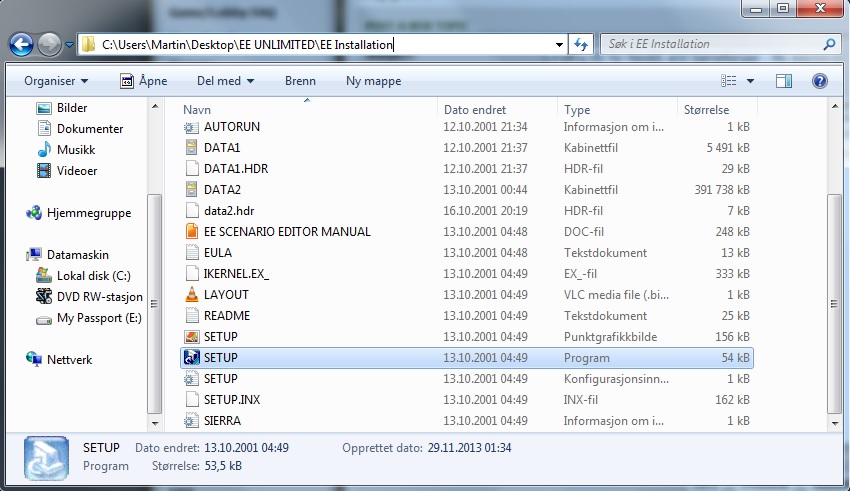

3. Press on "Setup". As shown in this picture: 4. In the installation process, press NEXT on everything.

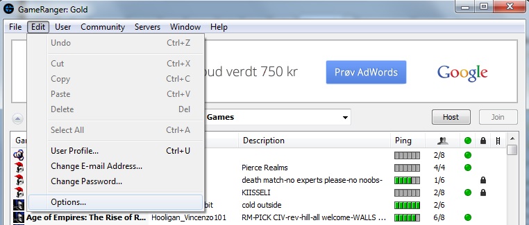

3. Press Edit then Options, as shown in this picture: 4. Scroll down to Empire Earth, press on it, then press browse. As shown here: 5. Find the Empire Earth GameRanger folder and open it press open.

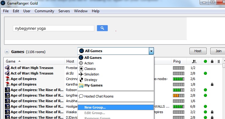

6. Press on Empire Earth.exe and then press Open. See picture: 7. Press on the arrow on the right side of "All Games" in GR, and then press "New Group" 8. Give the group a name, scroll down and find Empire Earth and then press "OK". Install NeoEE
