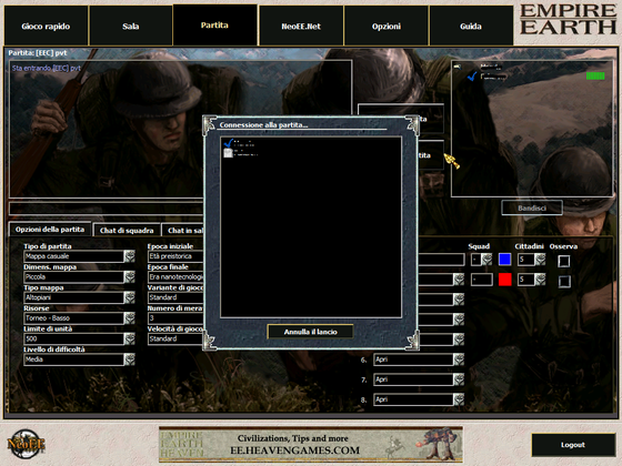

For starters I think it's better to clear out the fact that we're trying to play on AOC. Sadly someone is still having problems running EEC even with NeoEE installed, but probably I could try and figure out what their problem is.
Anyways I'm testing right now with two laptops, one as host (port forwarded) and one as client.
But even disabling on both computers the true/false value, it didn't affect result.
I just made another attempt on EEC, by the way, to try and understand, but it looks like the problem is the same.
Basically in the picture you can see what happens not only on my other laptop right now but even with my friends when we try to join the game.

ah okay AOC, so first of all NeoEE host system is only for EEC. The only thing i can think of causing this issue is that your ports arent forwarded correctly. What i would do , is to find someone who has opened ports and test with him, so you know whether its your host being the problem or the players who try to join. You can contact me in Lobby as "Die Gurke".
Also maybe try to contact Jodocus, hes the one building this lobby and probably best in this stuff.

You convinced me to dig in that direction and it was correct! :D
Thanks for the help! My crappy-ass router (provided by my isp) had a few bugs in providing the correct port forwarding... Right now it works! Wow... Finally... I can't wait to play!
