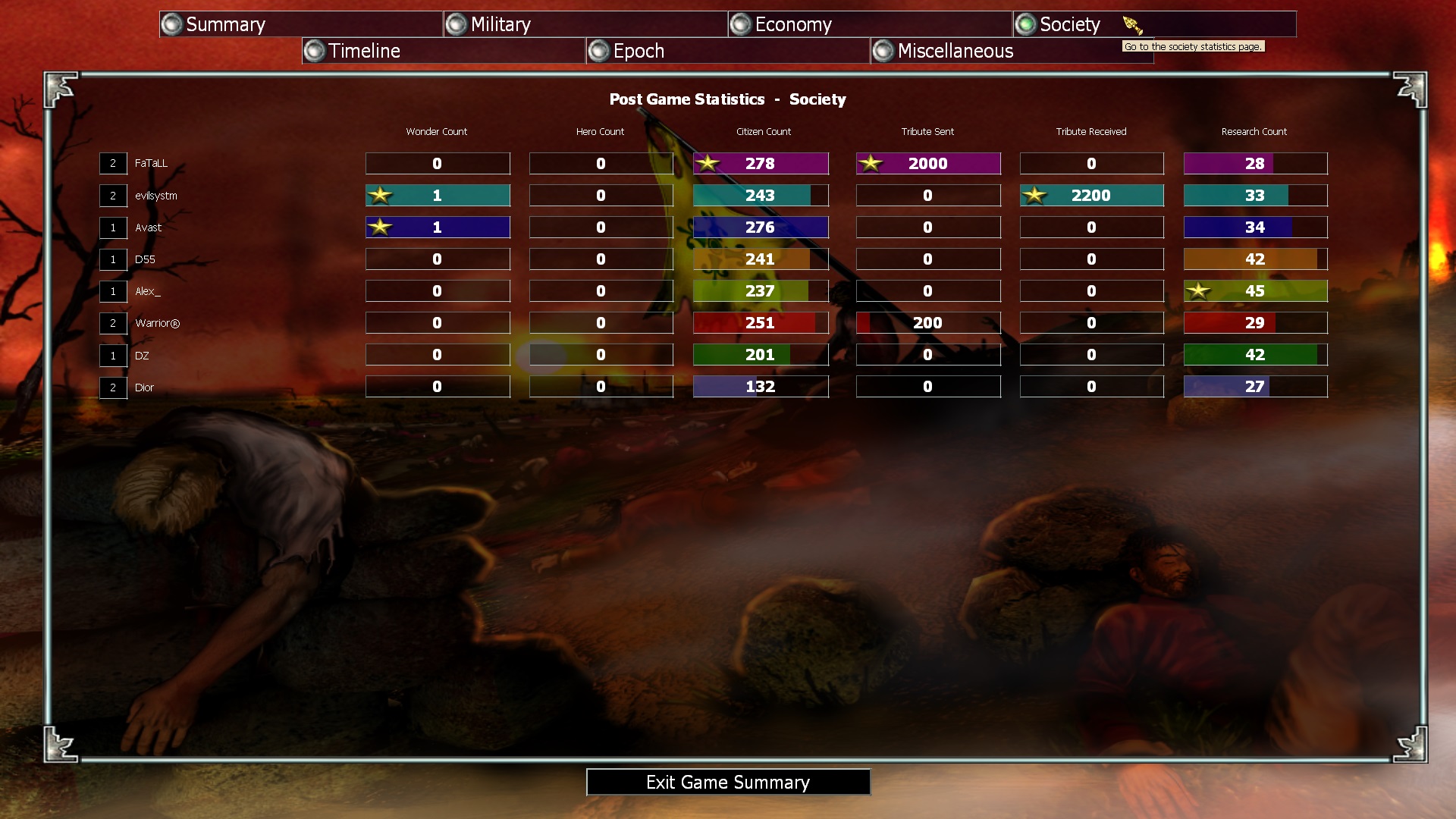

player name is Warrior®

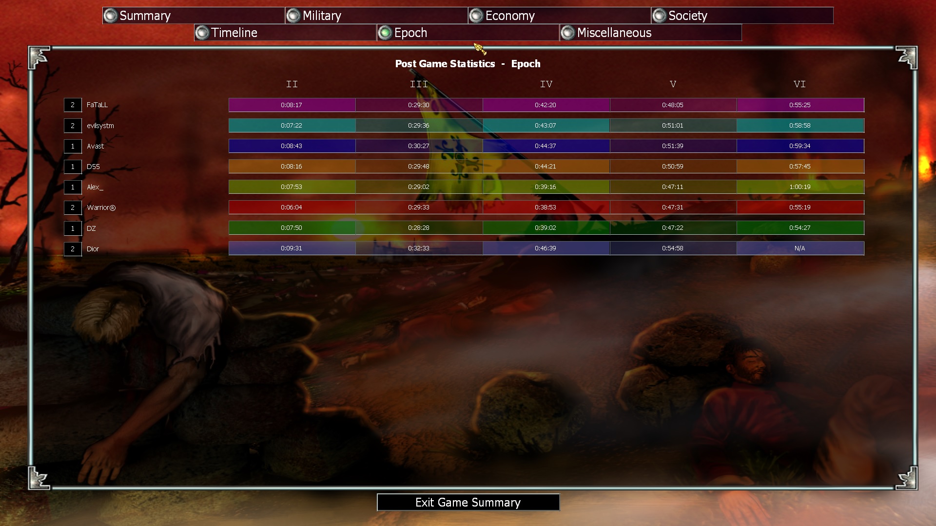

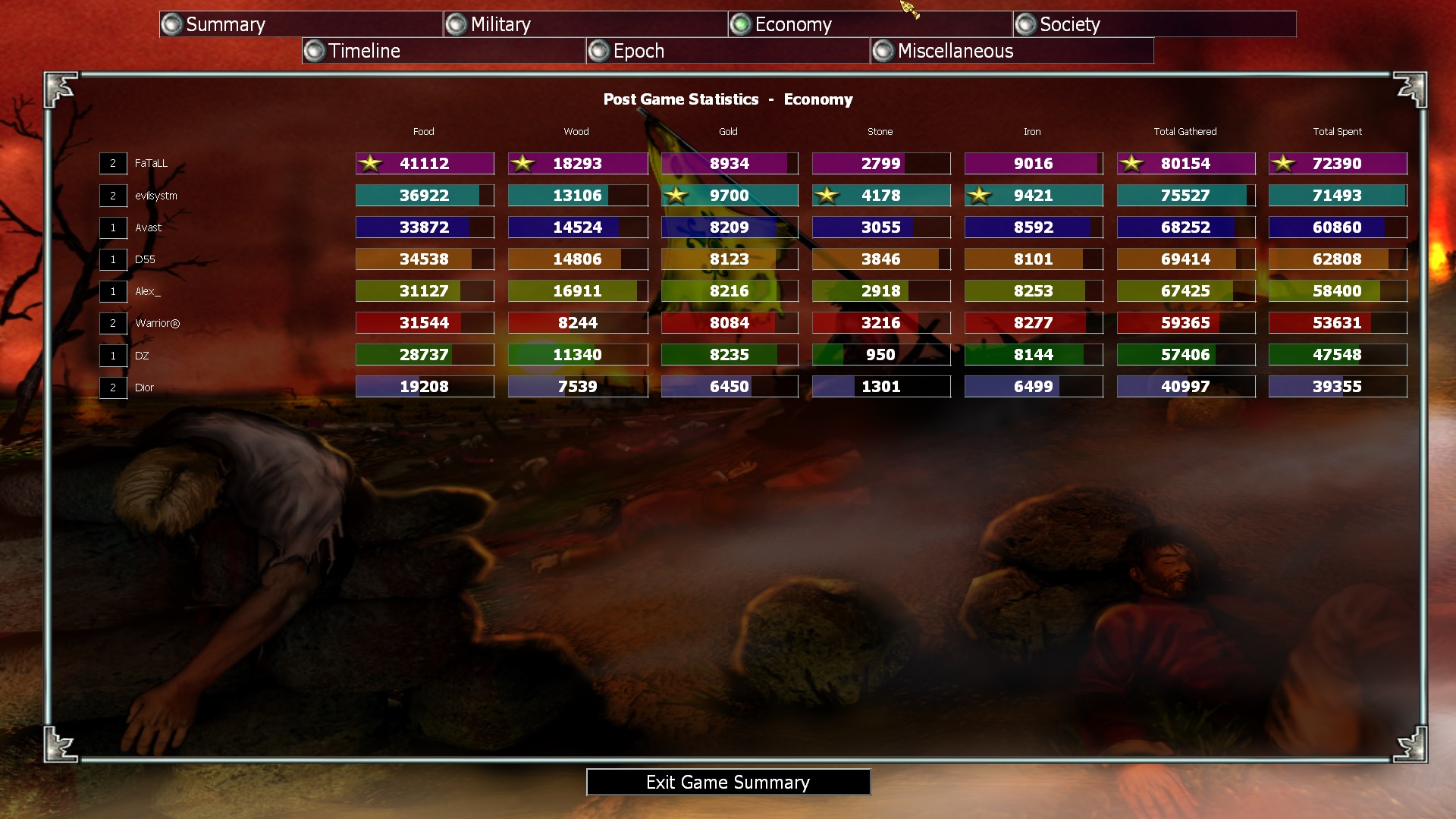

As you see he gathered a total of 31574 food. In game he had a 3453 food. If you look at his captials as him you will see he has them popped and several cits in production. with the cits he currently has and the cits in production, this comes up to 640 cits exactly I believe. he aged from pre to middle which cost a total of 12,342 food. cits he had and are in production cost a total of 25600 food. 25600+12342+3453=41395 food he would of needed so he glitched 9821 food if I am correct.
Edit: he starts with 800 food and 20 cits which is a total of 1600 food less glitched. so he still glitched 8221 food
I think he glitched iron later in game to as he was able to epic quite fast even though he kept flooding seige. So please let me know if you want more saves and I would appreciate if anyone could double check this.

Ok I'm just going to look at food spend here. d555 loaded me on him with the drexmod so I could check out his production.
If we first look at citizens, he has:
In production, 4*44+29+3+24,
Popped: 50,38,26,7,27,50,15,23,
current pop: 2 fisher, 223 total: 221 total cits
Now he had a starting amount of 35 cits
Makes a grand total of: 4*44+29+3+24+(50+38+26+7+27+50+15+23+221)-35=654 cits produced
So, if we look at the sum of his food, we hit 26160 food spend on cits, and he has 3468 on stock. He has a production of 31544, so he had 6184 to spend on epoching to Mid, and I am pretty sure that's not possible.
Bottom line: I'm not sure where the difference of 14 cits comes from, but his food production does not make sense.
